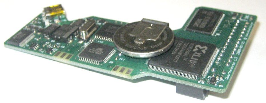

Binary Editor is software that accesses the tuning hardware that connects to the Ford computers (PCM). The hardware being a TwEECer or Quarter Horse can be utilized for real time tuning and datalogging.
Everything small with logo
2ugclyv
DO NOT PURCHASE ONE OF THESE USED, this is the old unsupported parallel port version of the TwEECer RT, notice the ribbon cable.
