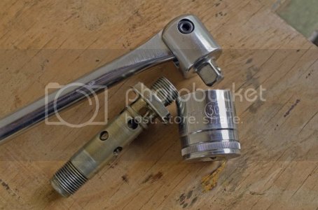

0501132122_zps75fdcaee.jpg.html
Alright boys here she is
http://s1346.photobucket.com/user/tuckergrimley/media/0501132122_zps75fdcaee.jpg.html

This is what it looks like, but it shouldnt be this warped. This was the one i just replaced. The bolt you are referring to that you attach the oil filter on is used to attach the oil cooler to the block. The bolt is threaded on both ends. One end goes thru the cooler and into the block and the other is left exposed so that you can attach the filter.
IMGP3792aA 28 zpsb6cdefe3
IMGP3787aA 28 zpsa845e694

What happened to your old one?
The bolt doesn't wear out, the cooler can - but that appears to be few and far between.
Doug
It just isn't there. This is an extra engine I got with the can that I am rebuilding and it's just not there.
