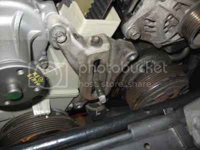

does anyone know that the tensioner for the ALT/AC belt has a bolt hole in it around the water pump area... I noticed its missing that bolt... and you look through the hole in the tensioner and theres no threaded hole for a bolt to go on the other side of the tensioner.... so does the waterpump for a 3.0 have a spot for that bolt to go on through and when the ******* who did the water pump realized theres no bolt hole just didn't put that bolt in there and thought everything was kosher and didn't realize there was a problem?

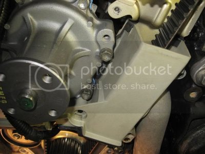

another thing I find odd... I took this from the SHOPP sight..... I said I had a missing ac/alt tensioner bolt.... and behind it was nothing... no hole for a bolt... and the other two bolts were on the tensioner so it had to be lined up properly....
now I look at this pic, on the right side of water pump, there is a bolt circled.... now above that bolt looks like a big ******** for a bolt in about the area for the tensioner.... man that really makes it look like I have some bogus ass water pump....

I think its more the water pump... I could check out the crank but the water pump is just too suspecting.... that guy posted some nice clear pics of his water pump and tensioner.... that big ass bolt that goes through the tensioner and into the water pump is gone on mine... and u look through the hole in the tensioner and theres nothing behind it for a bolt.....
thats really bad news if its not the same and the reman one doesn't have provisions for that bolt.......... that really points to it being wrong....

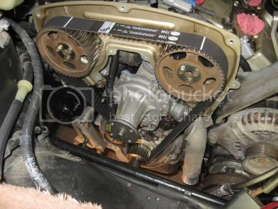

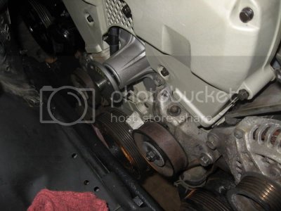

Here's a couple pics I ran across:
MTX:
ATX:
You can see that there is the extra holder for the CPS wire on the ATX pump.

also notice the gasket is the same? making it appear as if u could bolt a 3.2 water pump onto the 3.0 engine/water pump housing...........
I've been studying the shit out of some pics from rock auto..... one thing I noticed was the ATX pump is DEFINETLY shorter... what I mean is the snout isn't so long
I also noticed in those two pics the area where the pulley bolts to looks different between the two pumps, I'm thinking about taking that pulley back off and looking to see exactly what it looks like for identification purposes.......
