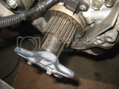

If you can do rod bearings, you can do the front 60K. It's not bad at all if you take your time. Just follow the shophoenixproject.com guide, and there is also one on shotimes.com that helps with disassembly. The only special tool you need is a puller like in the picture. The timing belt cover bolts work perfectly with it. The hardest part of the job is changing the rearmost cam oil seal. Shophoenixproject has one way, I have slightly different variation.
