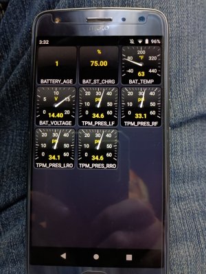

Battery Monitoring System - There is a sensor on the negative battery cable that monitors current use. The body control module keeps track of battery age (in days) and state of charge (in percent). A scan tool is used to reset the BMS so that the battery charges properly. After installing a new battery the BMS will reset automatically if the car sits for 8 or more hours undisturbed. However, only a scan will reset the day count. Forscan and Forscan Lite can reset the BMS.
You can also set up gauges in Forscan Lite.

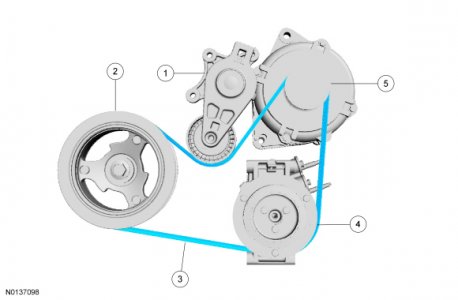

The rough idle and slight ticking haven't gone away though, and now I'm circling back to my timing chain and water pump again because this is different than how the car has run for the last year I've had it. Is there any way for me to check the life/health on those parts without physically getting to them and ripping the timing chain cover off?
You can use a scan tool to compare desired cam timing vs actual cam timing. Should be close to zero difference. 5 or more indicates chain stretch.
Remove the accessory drive belt and see if the noise goes away. If so, check the tensioner pulley, alternator and A/C pulley for roughness, looseness etc.
