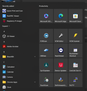

FORScan, Cyan Labs, HP Tuners and SCT software are exclusively why I bought a Windows surface laptop. Probably also why I can’t seem to buy something other than Ford.
Same here - even use the laptop in the car - use a RAM laptop holder with a quick release.
Just a few of my dedicated tools:

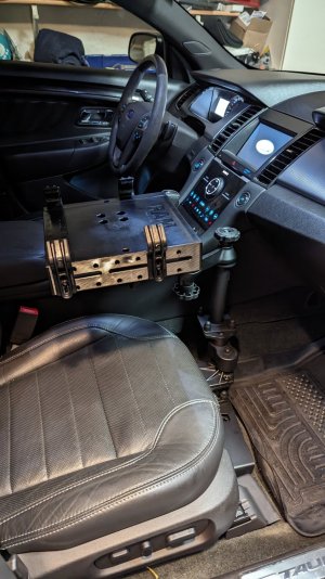

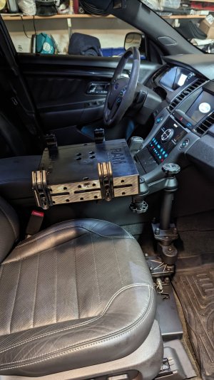

That RAM mount is a great idea! Is it obtrusive or obvious when stowed away? I am seriously considering buying one.
I love mine, I will take a pic when I can. I bought the quick connect as well, so all I do is pull a pin, and it pops out. It's pretty heavy unfortunately, but it is very stable, and great for data logging. The one on Fortheworkshop.com is much lighter than this one. It's very rugged and highly recommend it, will say this peeps definitely think I am a cop. For me I take it out when I don't need it, however you can fold it down pretty easy.
