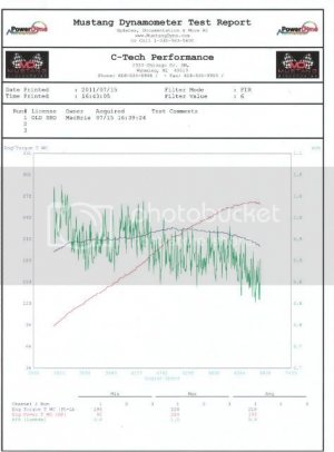

So I went to the dyno tonight (Mustang MV250 HD) to get some base numbers before I put the 3.2 with stage 1 cams in next week. I was quite surprised!
Basetune
Since it's a little hard to read, that's 264whp and 228wtq. Stock 3.0 w/ California emissions.
Now, he just had this dyno installed last August, and says he's been having problems with the 'lower horsepower' cars reading high. We tried re-calibrating a couple of times, but still had the same results.
One thought, I thought that 4th gear was 1 to 1, but after checking my Car and Driver, it looks like it's 1.02 to 1. Would that change it that much? Even if I divide what I got by 1.02, it's still to high. Any ideas?
As long as nothing changes on the dyno, I will still be able to see gains I get after the mods, but it would still be nice to get the correct numbers.

What are the details on the car you dynoed. It is for surely messed up bad unless you have cams now it should have even peaked at 6200 ish it did not. I would for sure go somewhere else and get it done who knows how wacky that is.

As far as using this as a comparison, that graph is garbage. If there was a problem or mis-calibration, I'd hope he would have it fixed before you made it back. The AFR (Lambda) is all over the place as well, was he having issues with that too?
At this point, we've got a pretty good idea of what it would make on just about any dyno. Just do your work and go back to ensure you've got it tuned well.

Maybe he charges his customers upon power their car deliver on his dyno! I hope you won't have to pay for that! Go somewhere else and make sure you at least get a rain check to go back when he knows what he is doing! Good luck with that and with the coming mod too!

FWIW, Your car should be making 170-180 FWHP on a Mustang Dyno (As they read 12-14% lower then a Dynojet).
-Sam
I told him right up front that I was expecting about 180.
I just looks like the AFR reader was either super sensitive, or it had a low refresh rate, causing it to jump up and down.
No, he just charges a flat rate.
He's doing a dyno challenge in August where you'll get your base tune in his dyno, and then you'll do another pull on a portable dyno at the Metro Cruise. I think I'll do that and compare. The only other option I have around here is ZZP Performance that mainly does GM front wheel drive cars...... which would probably be a good option, considering that's as close as it gets to weight and performance in a FWD car.....
What it looks like is that you went stoich(and above) under WOT. A low refresh rate would show LESS resolution. Either way, in OL, your car should be able to be smooth. If your car is truly jumping around like that, you've got some things to address.
He had a few others hanging on the wall, and they were all very jumpy like that as well, so I would assume it's his equipment.... hopefully....
I have a tweecer r/t that I've been trying to figure out (haven't hooked up to the car yet). I would like to get rid of the egr and put an 80mm maf in, and hopefully i can make some other adjustments as needed. If anything it looks like I was a bit lean down low as well. I don't have a wide band o2, so it's going to be hard to figure out how rich/lean I am without making a trip to the dyno. I'd still like to go back to this one afterword, but I'm definitely going to go somewhere else afterwords.....
