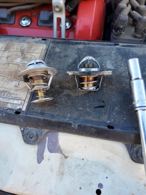

Forgot to mention, Beau. Did that replacement thermostat have a jiggle valve like the old one? Couldn't see one in your pic. A no-no if not.
