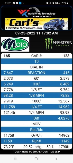

So my assumption that the Mustang dyno being pretty stingy was proven this last Sunday. Went to the drag strip taking it easy and only did about 60% of a pass. Here's the slip
Screenshot 20220925 112129 WWT Slips
Now an analysis of the pass. There technically was one pass before this but the trans went into neutral while brake boosting so I did a lap made sure car was going into all gears. Any who, this car has troubles getting into positive boost while brake boosting in general but with the upgraded front calipers I have been able to leave on 4lbs which is pretty dang slick. Today I couldn't even make positive pressure thus the 2.07 sixty foot. The car once in boost is absolutely screaming shifts into 2,3,4,5 marvelously but as soon as fifth goes in the rpms raise up to 6k but the car not quite keeping up with that rpm bump. Car absolutely blew through the transmission clutches. Trans is a new unit with like 5-7k miles on it too. Guess it's time to see what that spare transmission in my garage can be built to with what we have available. If you want to see the pass it's on my YouTube channel and it's not pretty. Lol

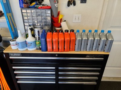

Lots of fluids today. Clearing some space know my shelf! I'd do all BG oils but I've already got a majority that need used!
Plan is to drain and fill the trans and add a can of BG ATC plus trans additive and send it. Worst case I still slip the same way I did at the drag strip!
