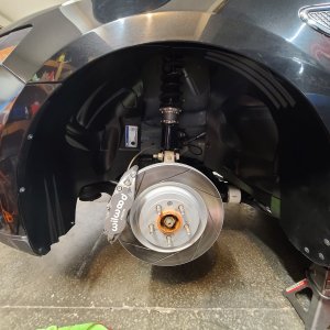

More pieces from @DadMobile ! Wilwood front brake conversion. I consistently push through the brakes at about 2k rpm trying to build boost on this turbo so hopefully these will help. Also the old fender liners were shredded from not having the front most undertray on so I replaced those as well with new oem ones! Just waiting on a couple adaptors to show up and it'll be ready to hold on place more than ever before!

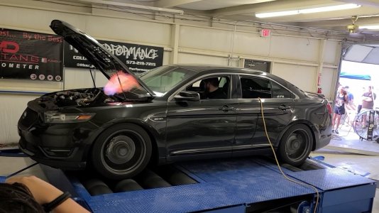

Had car dyno'd today. Mustang dyno so it was stingy but I'll take it. No proper torque and dyno in 4th gear
0% wastegate so just spring pressure
424awhp
35% wastegate
484awhp
42% wastegate
506awhp

Do you think your previous SHO would of made more power than this car if you had the opportunity to tune it??
Negative this thing has a higher ceiling than my last car. Last car on the Gen 3 turbos made 536awhp on a pretty happy dyno. Never dyno'd the gen3r but was out of fueling at the same psi as the gen 3. Car was probably making like 560-570 awhp with the bigger gen3r
Crazy that only 1 or 2 cars have produced more power than Mike’s 617hp even though we now have better fuel pumps, larger intercooler, larger injectors, E85 and better knowledge of tuning than 5-6 years ago. Goes to show that car was the real deal!!!
Dyno are still pretty useless for a car to car comparison unless they are on the same dyno. This sucker is stingy. Buddy's BMW with a cookie cutter tune that makes 500rwhp on majority of dynos was making like 450rwhp. Considering low timing, 93 octane and it being a mustang dyno. I need to update the entire fuel system. This is just an upgraded HPFP. Still stock injectors and stock lpfp. Heavily dependant on the direct port methanol system. Could easily turn it to 30+ psi and make some crazy power but no real point on the dyno. 42% wastegate is just the beginning! This car already went 11.50 with full weight like Mike's did and a big guy as the driver so curious to see what 600lbs less and some more efficient set up changes will do. Not too crazy about going for the record anymore. I've definitely slowed down a ton in my l-u-s-t for speed, but I guess I have a spare trans sitting waiting if I need it lmao. Engine is the most built transverse ecoboost I know of by far just everything else still lacking
