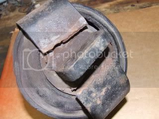

Picture013Picture012
Broken reinforced atx mount made by Hypermike after 2 year of abuse
So I decide to fabricate torque limiter along with stock mount, it work great now more bite even make 2 wheels burnout instead of one wheel peel.

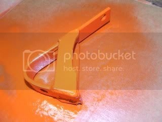

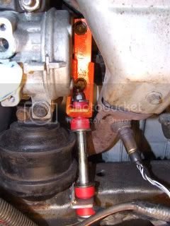

More Pics
nicely done Quick!
I would like any other pics you have of that!
I used energy suspension sway bar link and cut it short to fit.
See the notch on side of support bracket to clear air conditioner's end.

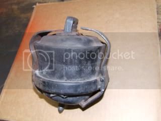

MTX mount modded to fit the 3.2.

Yes I have done the swap , yes I have the full 3.2 with all the 3.2 accessories mated to a MTX. BUT this is not the simplest route. The rear mount needs fabbing too We took a 79 conv mustang mount we had in stock for the rear one. as pictured:
This is on a MTX subframe BTW.

quik where does that bright orange beast atach to on the motor? existing holes?
