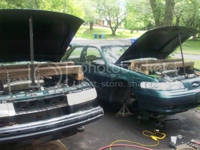

Here is the modified line. It consists of the pump side of a gen 2 line and the rack side of a gen 3 line. I brought the pieces to a hydraulic line shop and the put a swivel an type connection between the two line so they could be clocked appropriately.

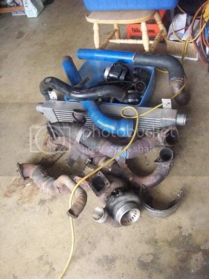

Ill give you a small update. Intercooler has been painted black, turbo is in pieces waiting on a rebuild kit and a new turbine housing. The old one was soo rusted that you couldnt get any bolts out. Took his fog lights out yesterday, then the charcoal canister. Once his paychecks start coming in, we will get the fuel rails bored out for the 30lb frpp injectors. Then we will buy some exhaust piping and notch the subframe for the up-pipe.
