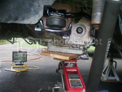

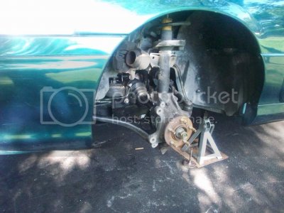

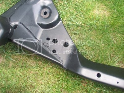

Me and Whiteguy3 just finished installing a gen3 subframe into his atx. This proved to be much easier than in an mtx. No modification is necessary to the trans mount and the rear motor mount. The front motor mount hole needs to be moved over 2 inches and raised.
108 0001
108 0002

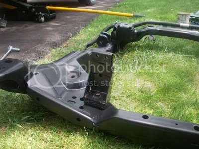

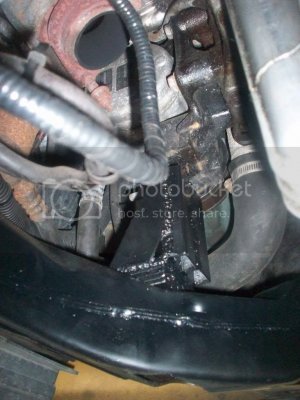

He created himself an all metal solid motor mount a few months ago so he just added some spacers onto the bottom of that.
108 0008
108 0019
One thing you need to know when using a gen1/2 rack. the studs need to be swapped from a gen3 rack into yours, the gen2 is too short. also, you need the swaybar brackets for the gen3 as well. other than that, this thing bolts up perfect.

Once all this gets done then the tri-flows go in.

7,521
how much do you have to raise the front mm location?
Sho Amo
SmkTyresntDrugs
Feb 23, 2006
3,299
856
Olney, Md
about 5/8ths. the same height you need to raise an mtx. basically doing exactly what you do to an mtx car without changing the trans mount.

Nice looking subframe. What kind of prep work did you do? Paint or powdercoat?
CK
Sho Amo
SmkTyresntDrugs
Feb 23, 2006
3,299
856
Olney, Md
Thats all Scotts work. He wire wheeled the whole thing and then primered and used VHT Epoxy. Turned out great. I think ill use Duplicolor gunmetal with a clearcoat.

lol, omg i have no idea how you got that trans cooler in there with an intercooler and oil pump. We had a hard time just getting the cooler/fan in.
