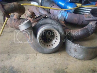

FYI the heat shield for the turbo hotside once lived as a cooking *** FYI. isn't it pretty for being 4 years old?
glad to hear the tranny worked out for you. just don't get greedy like we talked about with the boost and it will treat you good. What failed on your old trans? you could probably make a good one out of all those spare parts I gave you. - the actual case you have 1.5 trans worth of parts in bins now.
