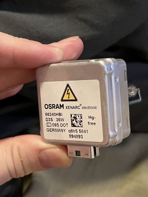

The exact thing I’m looking for is this: (photo attached)97FF34C5 1400 4F59 81C0 1FD1E773692F
I was looking online and found a 2-pack for $69.99, so I have no idea why they’d try to tell me it was $500 for a single unit.

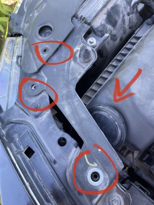

I also popped the hood when I got home, and not only did they leave bolts out of the housing, but they also left the headlight gasket just sitting in the engine well. These guys have absolutely no idea what they’re doing. 992C5A45 7E65 4022 8F23 35DF80EA4CD2

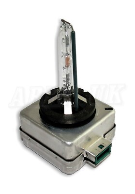

Ok. I thought you needed a housing in addition to the other part. I found this on ebay but it ships from China so who knows how long that will take
This one looked good. At least they post the fakes in the photos. Not sure if that makes them legit or not but..
Awesome, thank you for the link! Blows my mind that these guys wanted to charge me $500 for that part…
13,287
5,169
Yeah your description sounded like more than just that so wasn't sure. If it is just that part there should be simple instructions online on how to swap that out. Good luck
13,287
5,169
looking at Ford part number 7L7Z13N021A
or you can look for compatible aftermarket stuff from sylvaina or something
