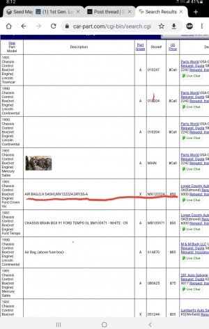

My light has been flashing 10 since I bought the car. Now, with the thermal fuse blown, is it safe to just replace the module, or will it just b l o w again? I looked on car-part.com and it looks like they have quite a few listed from various 90s fords, most around $50. I don't want to throw one in just for it to pop again, but I'm not sure what would cause it to short.

Cool. I'll call the yard and get one coming. Are crash sensors a common part?

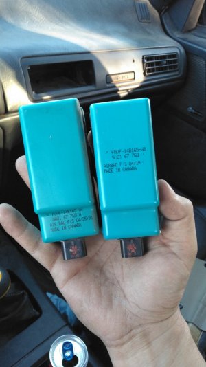

Went to the junkyard and found a 1st gen sable. Pulled the srs module and put it in mine. Still flashing 10. I think I'll just leave the module out and pull the bulb.

Should have posted this earlier. I did this one time after installing a used module that also had a blown thermal fuse. Seems intimidating, and i was surprised it worked. Take your time and have the proper tools. Heat sink and solder vacuum is needed. Found tools and capacitors from the last repair job. I did repace the capacitors, as the right up said, hoping that was the only issue and the cause, like the write up. However, my issue was a crash sensor. So, like i wrote before, be prepared to count flashes and turn off ignition before the system blows the thermal fuse as designed.
