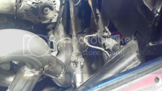

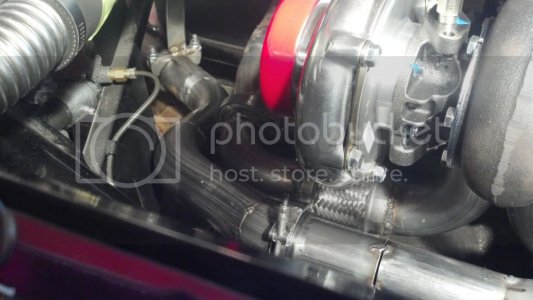

Update I finished up my turbo headers for the most part except for the pipe to ****** welding a couple weeks ago. Also i got my custom flywheel from spec finally and installed the engine and tko trans. I have a radiator on the way, so all i need is some wiring, some fuel fittings, and starter to be able to do a test start up. I hope to be driving it within the next month - month and half.

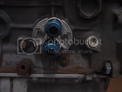

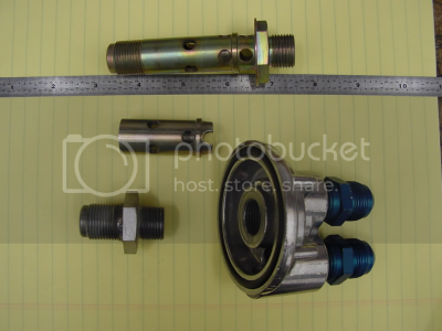

http://img.photobucket.com/albums/v618/92SHO16/Factory%20Five%20roadster/oil_filteradapt_block.png[/IG]
[IMG]http://img.photobucket.com/albums/v618/92SHO16/Factory%20Five%20roadster/oilfilterboltmod.png[/IG][/QUOTE]
Lol, i found those from an old thread of yours. I uploaded as a a backup.

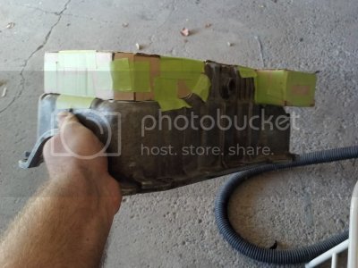

Ur gonna have to modify the pick up. Shouldn't be to hard I guess The pick up is pressed right up against the oil pan
Is it? I used playdough to get a measurement and i measured a gap of .36 inches. The issue I was planning on is needing some tubing with a sharp radius bend because there isn't a straight section that I can cutout.

Got an exhaust leak there :)
That's some tight packaging. Are you using a spacer between the intake and heads?
