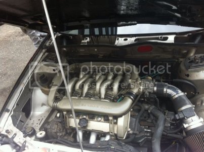

Zach do you even have a fuel cell in the car? Its one way to save weight.
Im trying to tuck and hide things in the engine bay, but the Booster and Cylinder are 1 thing I would leave alone. Not worth trying to rig something that is used to bring you to a stop. If something fails you could end up in the hospital.

Got rid of whole ABS stuff, by the only thing I did, was putting proportioning valve under the hood and took me some time and tires to adjust that. I liked the result and I don't even know if I need huge brakes now, since the car stops on a dime.
Don't waste all that money, it is cheaper than you think and not any less effective.

I don't see a booster. Are you now going to drop the cash on the proper pedal assemblies, master cylinders, proportioning valves, and build something to mount them on?

On the opposite side of the firewall.. Its a cosmetic mod. Trying to delete and relocated a lot from the engine bay.
