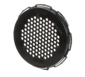

are there any codes for the seats in forscan? mine keeps shutting off on high settings due to overheating, another thing to check is the air filter for the seat. allegedly, there is a small filter under the seat, I have yet to hunt it myself but if its clogged it could cause some issues i'd imagine.

Those filters don't filter much of anything. As far as the seats, check the harness/connector under the front of the passenger seat and see if it has burned up. It's a pretty common issue on these cars. Here's the link on it:
From what I was reading - it can burn up because the filter media gets clogged - puts extra strain on the blower - and helps cause that issue with the connector. SO I would clean the filter - water - or just replace to that newer style to avoid putting extra stress on the blower.
