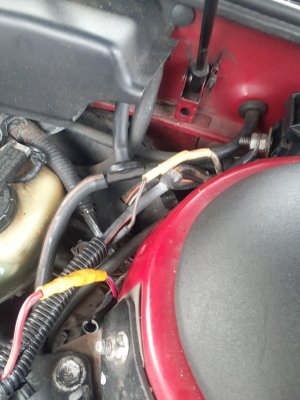

I found a bare wire an I don't think this should be like this. Motor an trans have been replaced an I think the harness got chopped. I checked all grounds they r good. I have a cam sensor if its that but I think there's more. the wires in the pic the black a red wire get hot

If I had my evtm manual I'd look for it but that has been gone for a while. Hopefully someone can give you a good answer. You can look at the cam sensor wiring plug and see if the colors match.

I don't think they put the harness back in correct spot none of the pins r in an holes. I just bought the car last week paid 2500 has tons of records on the car 25k in receipts
13,265
damn. there are wiring manuals that have the routing and color codes like red with brown stripe and you can see where it is supposed to go.

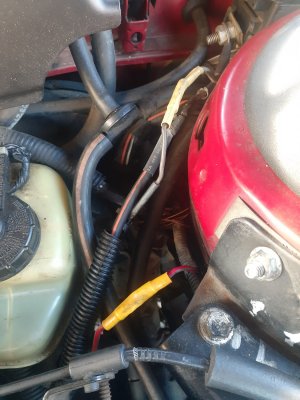

Well I took wires off from alternator an starter cause it was getting hot an found more bare spots so I'm making a new wire. going to check codes to I'll post what codes I get but check engine light is off now

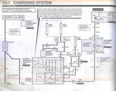

Do u know the fuse able link amp in that wire

MTX, duh!.....Here is the charging system for a '94 MTX. '95 won't be different. Doesn't say what amps the fuse links are.
