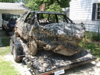

im looking for some other parts too like a new computer mines got a hole in it lol, maybe a balancer. how can i test the sensors and modules? i ordered a chiltons manual to get some specs to test stuff. i pray its not the crank sensor that means i have to replace the balancer and time these damn things. its broke and temp welded together to get me through the race last night.
just thought a pic would help show what happend. car+car at 40+mph hurts
