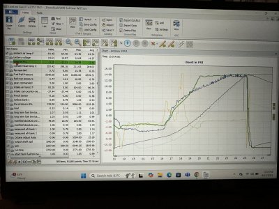

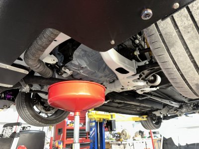

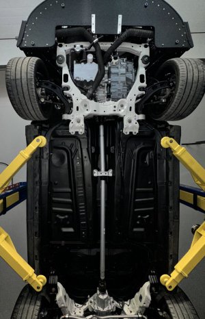

About to throw the car on the lift and double check the axle seal. I let the car drain for at least 12 hours. Actually ended up putting in nearly 8 quarts from this drain and fill. I do have a rather large trans cooler as well. It shifts great, the fluid looks more like ULV (thinner than LV). Last data log for this break in (detuned) setup. Final mileage around 370ish. I’m iffy on the mileage and underestimating for the benefit of the break in. I get all kinds of messages on first start and I’ve accidentally cleared my trip twice. It’s got 320.3 on it now. But I cleared with a little over 40 and then had like 10 I cleared. Just rolled over 77,000 miles.
Here’s the data. IMG 5682
3rd gear WOT pull. Full boost at 3300rpm. 14 psi boost maintained no spike. 23% WGDC. Fuel rail pressure is progressive bc of boost referenced FPR, at around 2500 rpm 6,000 rail and progresses to 16,000 maintained, shifted just over 6k rpm and looks like no reason to shift that early.

Brad said the log looks clean as a whistle. Want to just start adding in boost? So after talking with Brad the plan is around 18-20 psi boost. Should feel fast AF he said. He’ll keep the spark conservative at first to see how it does and he’ll raise it until I’m at the limit of 93. And with this new setup, the turbos and fuel system …the only limiting factor here will be 93 itself.
