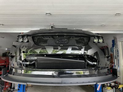

I’ve been analyzing the ambient, IAT and IAT2 temps. And Basically how I understand it is this. My fresh air intakes behind the grille are the best they ever been IMG 5683
I’m getting about 10 degrees below ambient for these 3rd gear data logs. While that’s fantastic it doesn’t necessarily equate to lower IAT2 temps. The initial cooler air is beneficial for the compressors but not by that much. The air still compresses and gets heated in instantly. Like a *** of water at 90 degrees and a *** of water at 120. If you boil them they reach the same temps..
The amount of heat these Garrett G25-550’s make at 22-18 psi is likely 3-400+ degrees getting funneled into the intercooler and for it to cool that down to 107 is actually characteristics of an exceptionally well performing IC. Doing a fantastic job.
So ambient in my pull was 69. IAT was 59. IAT2 was 86. Inherently heat soaked a little from my driving around to get OAR back up and idling to wait for a clean chance to do this pull. I did the 3rd gear WOT pull and ended IAT2 at 107.
86-107 is 21 degrees. So like how it’s great the intakes are getting such fresh cool air better than ever before IAT2 is likely exactly the same during this pull as if it were getting fed 90+ temps from a poorly positioned intake inside the engine bay. Edit to say same increase. If my IAT2 started at 100 it very much would have likely ended the pull at 121-124. Same cooling aspects. It’s not starting at IAT it starts at IAT2 and depends on heat soak. I could have driven longer to get IAT2 down and run the log… let’s say I drove and got it down to 75, likely would have ended the pull at 96-97.
Thus the IC is a non issue and this is just pump gas.
