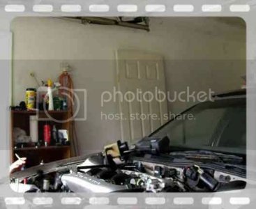

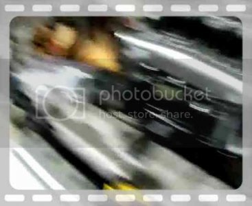

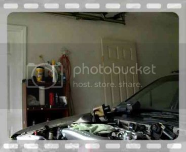

Ok, here ya go!!
Sorry guys, the internet at the house has SUCKED!!
First Video:
Th DSCN0452
Second:
Th DSCN0454 1
AND FINALLY!!
Th DSCN0456

uh, well.
The purpose of Tom's tool was so that you didn't need to use a hole saw to remove he ******. It was to neutralize the crank so you can put a lot of torque on the bolt...
Good work, though.

Well, we wanted to make our best effort. there was no WAY I was expecting it to make it that much easier.
Also, the only place to brace toms tool was the axle. It was a little, um, long. I didn't want to put too much pressure on the axle.
TOM! WE NEED A NAME FOR THIS TOOL OF YOURS!!!
