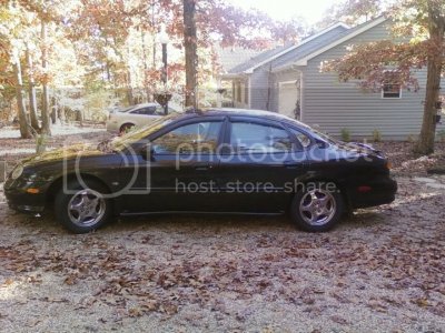

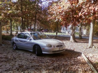

ok, so how many of you gen3 guys and gals heard of this?
i have found a new sho friend who lives in central va the lake monacello area to be exact him and his wife have 2 gen3s one is sliver with gray and the other is ebony satin and mocha both have flowmaster mufflers on them and sound great but heres the thing his wife's car the sliver one has 133,*** on it and the cams are not welded and it runs great, here is what got me tho. his car is the ebony satin has 238,*** miles on it cams NOT welded and still runs just like a champ

give it time....there is no specific mileage when the cams will fail, i have heard of them failing at 25,000 miles and 250,000 miles, and everything in between.

thought so i told him cuz me and him kinda walked around all 3 cars talken about it and i told him about the came needing to be welded he said he planed on done that just hadnt gotten around to it yet.
