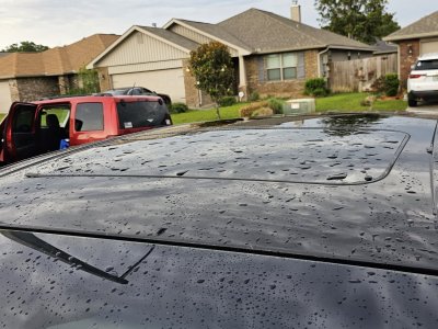

It's not flush on the front left corner. Plus I guess the drains might be clogged. Water is overflowing into the headliner, running down the a-pillar, collecting in the dash, and then running out into the floor where the carpet now smells rotten.
Joe_Cool
Apr 16, 2007
229
38
Atlanta, GA
As you can see, the driver side corner is low (that's where it's leaking) and the passenger side is high. How can I adjust that?
Wow, you should of just took it to the dealer. Spent 80$ months ago and wouldnt have any issues now.
