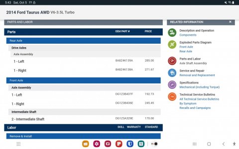

Year & PP or non PP?

When I did my CVs I could not find the single one-piece axle so I had to order the two pieces. Unfortunately I did not notice the difference until the front end was already apart.

I just replaced my passenger outer axle, part TX833 Motorcraft on Amazon (a really good price), for a 2017 Taurus AWD 3.5EB (SHO, Interceptor use the same axle). The inner axle should not need changing unless the hanger bearing is bad.

That's the issue... The OP and I both had single-piece (full-length) CV axles. Where your inner and outer meet and can be replaced independently, ours has a ~3 ft axle.
I swapped mine to the inner/outer version December 2022 and never looked back.
