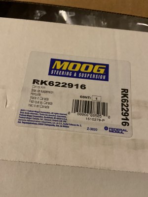

Well I pulled the trigger on a 13+ Moog LCA as there was actually one available, haha, and from what I've heard and researched it should work. I spoke with Moog tech on Monday, all he could compare for me were the differences between the rear bushings as they don't make an arm for the 10-12 cars. There were only a couple of minor differences that seem irrelevant as it comes as a kit (arm and bushing assembled).
Put it in this afternoon. Compared them side by side once I got the old one out and took/compared some measurements, everything seemed to match up. I haven't had time to drive it yet but visually everything looks right, guess I'll find out if I scrub the front right tire off, lol.
