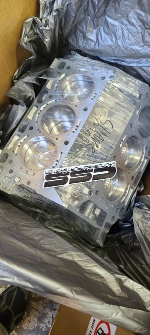

Quick update!
Talked with Matt from Turbo Bay and got my invoice...... Turbos should be shipping next week along with other folks SHO turbskis in que. Just waiting on the wheels. Not gonna lie, seeing "full race build" has me in full marketing sucked in mode, LOL. Let's hope for the best.
Screenshot 20220427 185421 Gallery
Seeing what he does, I'm glad I just sent in my stockers since they basically don't get recycled.
Valvetrain is still about 4 weeks out so, my motor will stay in shrink wrap, taunting me.

Quick update!
Can't wait to see the pics when you unbox them.
