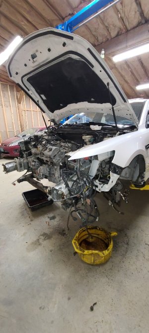

Pretty excited how things are coming along.
Time to start making some phone calls.
Next thing to research is the trans.51d3dfacd2c5b8722306b489b7cfc7a1
Sent from my SM-G988U1 using Tapatalk
