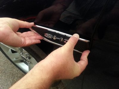

its super ez just slide a card in the top you hear the clips sorta pop just be sorta gentle and it flops right out. the clips where in the part i think not the fender

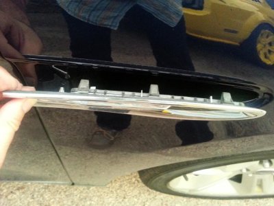

A How to -
20140506 101655 zpsg2rrpscv

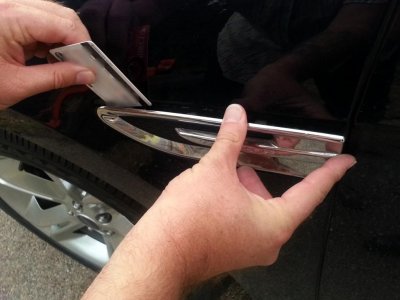

Three points across the top...push credit card down to unsnap and it from the top then it just lifts out.
20140509 200516 zpsdurmkrzx
See the clips? Just push down with the card on these points while applying outward pressure to the emblem.
20140509 200311 zpss1tpcg9k
Then just mount your new one in bottom first -
20140509 200612 zpswk1zeljs

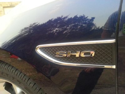

WHALLLA!!!!!
20140509 200645 zpsmu6c5r4c
now tackle the other side.

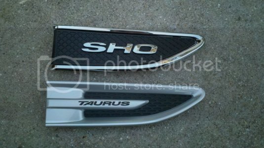

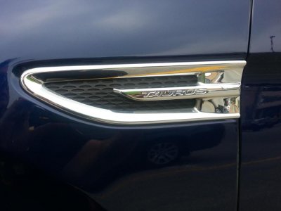

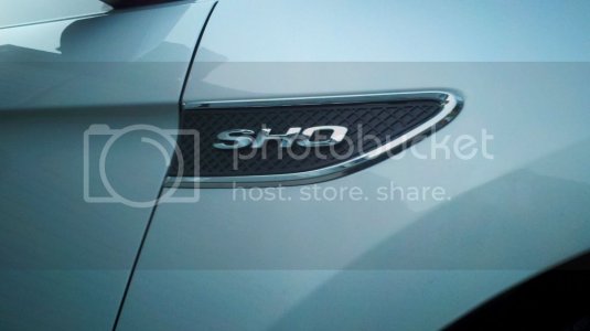

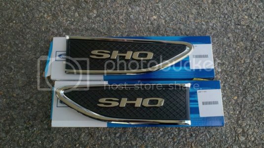

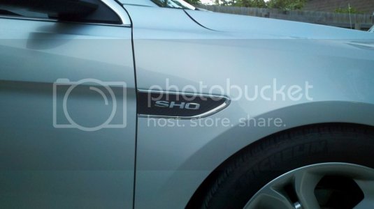

OK guys, the moment of truth for those wondering. YES, the 2013 vents fit the 2010+ SHOs with no issues. I ordered mine last week, they came in today. You want to talk about pulling teeth to get these things. And then getting the part numbers and pricing was even harder.
I just told the parts counter lady to get them no matter the cost and send them to my shop. She had to say that an insurance claim was being filed and to expedite the info. I may end up having them painted to match the car like my old ones were but I do kinda like the chrome on these. Here are the pics, let me know what you guys think.

I ordered these from the dealer and got them the next day. The install was easy. Looks great.

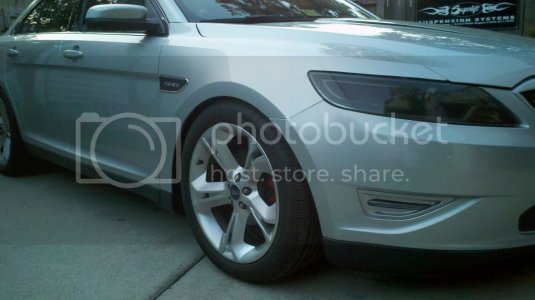

That looks AWESOME! I want them now too! lol... hey... how did you get your calipers red? Are they aftermarket calipers, painted, or covers?
