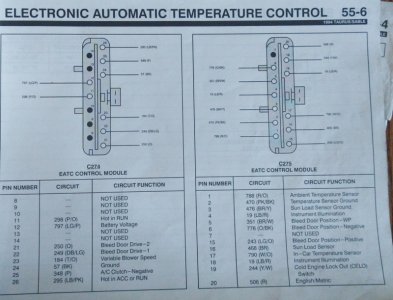

The 1993 EVTM shows that the EATC control head has 2 electrical connectors. C274 and C275
At C274 check the following pins for power and ground.
Pin 11 circuit 298 P/O this is Hot in Run position of the ignition switch
Pin 12 circuit 797 LG/P Battery Voltage
Pin 24 circuit 57 BK Ground
Pin 26 295 LB/PK Hot when ignition is in ACC or RUN.
Y

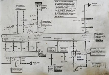

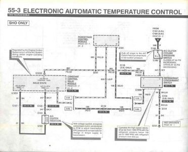

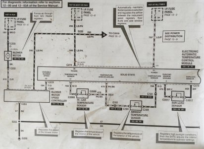

For a 94...
