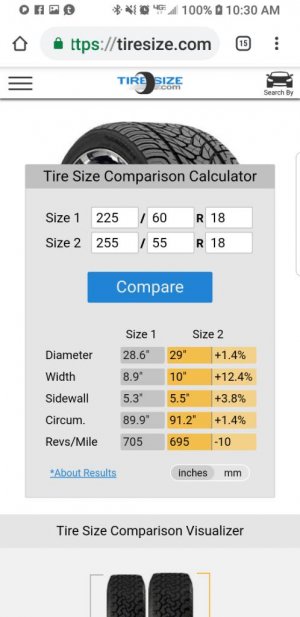

First pic is my winter tire size compared to your 255/55/18

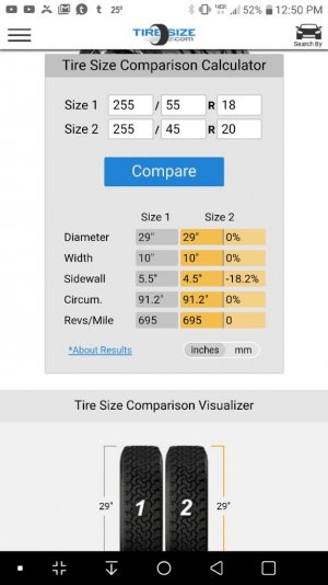

Second pic is factory 20 comared to your 255/55/181f5e931e45589219440006795082e3b230892304f0688f60f2723782dc738ba5

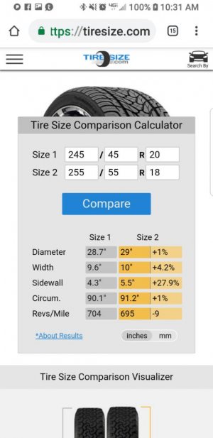

So based on a fairly common swap 255/45r20 from the stock 245/45r20, the 255/55r18 has identical dimensions with the exception of the sidewall height. I am pretty confident these will work without issue.
Thoughts?A59c9ba9d0895d878df74acc927929af

I didnt remember until I looked at my car, my blizzakz are 255/55r18. You should have no problems.
On a side note, skinny tires are usually better in snow and mud. They are like a cookie cutter vs a rolling pin. I dont have too much trouble with mine.

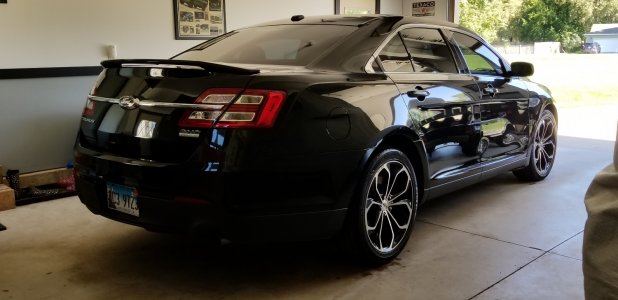

Its amazing to see the difference in gloss black vs tuxedo black.

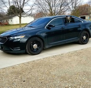

18s on mine police wheels are heavy so looking to get some different rims same size though
