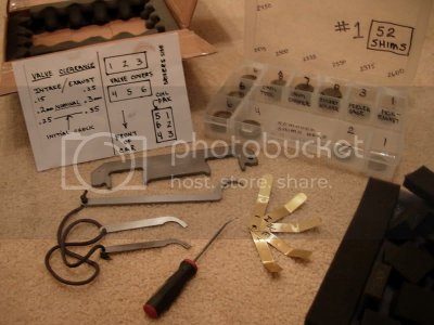

Shim Kit
I have a shim kit for rent with everything in it you will need to do the Valve adjust & more. Its $50 plus $15 ship. Send a $250 deposit & its yours to use for no more than 2 weeks. Call for details-See my ad in the Clasifieds-thanx

With the valve lash tool and shim kit rental you are looking at ~ $110.
--You do not have to buy the tools! Just rent the kit-every thing is included. Or just go to an auto supply & buy a set of feeler gauges-$3- and at least just check the clearances- you may be OK.

Shobill's valve lash tools
Bought a set of valve lash adfjustment tools off of shobill. Have done 2 valve lash adjustments so far, stuff works great.
