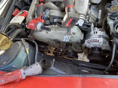

Update pictures! Okay so started tearing into the old SHO today. Got most of the accessories and stuff out of the way. Tomorrow is time to dig into engine!
Engine 1

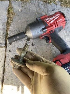

Crank bolt no problem!
Engine 2

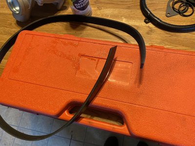

Unfortunately when trying to loosen alternator belt the c-clip holding the tensioner screw in place broke off!

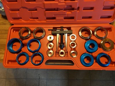

New Crankshaft/camshaft seal puller and installer!

13,266
Those old parts are brittle and weren't that durable 20 years ago. Don't overtorque anything there (like pulley/tensioners and their brackets) because broken sheared off fasteners with crappy angles and no room to maneuver sucks!! BTDT in the front timing area and the back valve covers.
Careful with the timing cover plastic and it is not 1 piece there are overlaps when you go to remove it.
