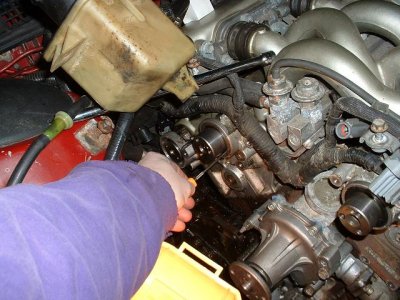

So I am looking at the cam seal replacement process and I am wondering... how did he punch a hole through the seal? I got the replacement seals and they have a metal ring in them coated in rubber. Are the original seals not like this? It seems pretty sketchy to try and punch a hole through metal. Am I wrong thinking this?
Step19a
zoomlater
May 31, 2004
3,684
1,905
Seattle, WA
They are metal. There is a picture where he uses a block of wood and a wonder bar to push a punch to make a small hole in the metal. Then you use a screw into the hole in order to pull it out

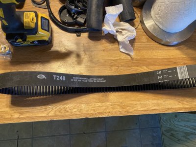

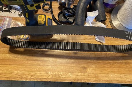

Also... the timing belt I got off SHOSource doesn't have the timing marks for the cam sprockets. How am I supposed to line it up properly?
zoomlater
May 31, 2004
3,684
1,905
Seattle, WA

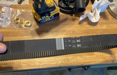

I would take a picture and contact Shosource. Are the other lines there? If they are, you might be able to line up to old belt to the new belt and mark it. Make sure the wording on the belt is in the same direction as its possible to install the belt backwards

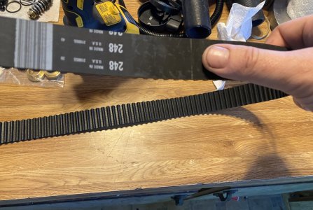

Here is the belt. As you can see only the crank sprocket has marks. Nothing for cam sprockets. I will contact ShoSource and let them know.
IMG 0650IMG 0649
Blackdr16
93 SHO
Jul 15, 2009
188
50
Washington, Illinois
Can't quite tell from the second photo - does it have the white dot on the outer edge of the belt where the belt lines up with the dot on the sprocket? Feel like I've seen some belts use just the white dots on the outer edge but its been awhile

After talking with ShoSource it appears there is some faint lines on the belt. Gonna give that a try and see. Picture of said faint lines. Do these look legit?
