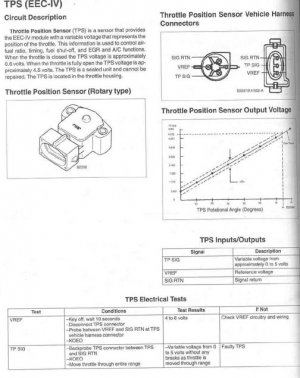

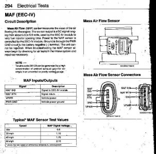

Probst tests attached for the MAF and TPS. These will tell you if the sensor is bad, or it's something else.
