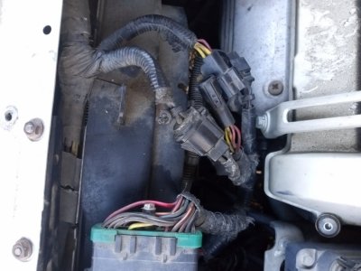

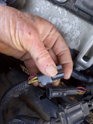

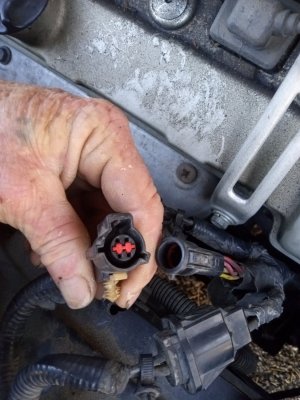

Ok it's back the same fuse. Car won't start. Tried everything I did in the past. Got the car to start and thought I had it again and put my car back together. When I was done the dam thing wouldn't start again . However I now have figured out witch connection it's causing the problem it's one of the plugs above the radiator round with two yellow wires and I'm not quite sure what the other color two wires are or wild waters in total and I have no idea where other end of the wires go but once I unplug that and crank the engine without blowing the fuse they do it with plugged in those two fuse every time then I have to track down where the virus go anybody got a clue let me know appreciate it have a good night

take a picture of the wires and post it here

Thank you for the idea why didn't I think of that.
