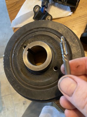

SO I am Sol on the crank pulley. I can't get the broken bolt out. I am afraid that if I try to drill it and use and extractor all I am going to do is break off the bit. What now?

Okay so I got to thinking what about just drilling out the bolt and tapping in new threads. I am wondering how much this is going to throw off the dampener. Thoughts? I am going to go and get a set of extractors and try to get it out.
13,266
I think extractors are the best option. I've done hardened suspension bolts and soft aluminum bolts in the heads. It should come out.
Whatever time you plan on 1st time attempts ..always triple it. As frustrating as it is, it's not uncommon for these things to happen.
Wohoo! Crisis averted! Thanks for helping out! Much appreciated!

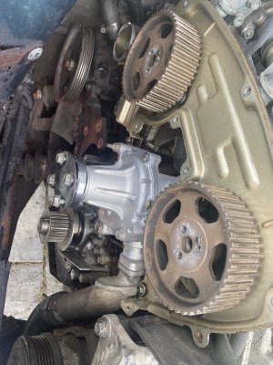

Okay so got the new seals in and water pump. Working outside in 90f weather is a toll! You go into fish mode and water is your best friend! Anyway taking a break.

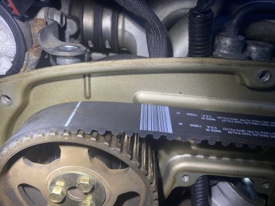

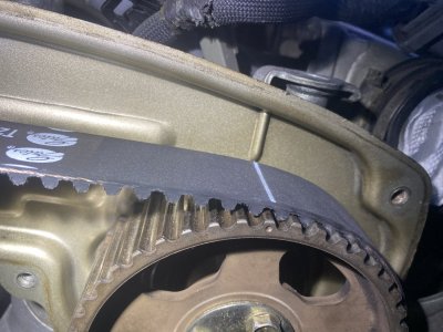

Got the belt on finally. Tensioner spring wasn’t that bad actually. So I guess the issue was the crank itself was not lined up right on the marks
A03B2E42 2ED8 475E A5DD C01F21A3DB19
38D67142 142B 4904 BAAD 960EBFAD8465
41E56385 D79C 4ED8 A679 6A9A77929F43
Tired, bruised and need a drink. Until tomorrow.

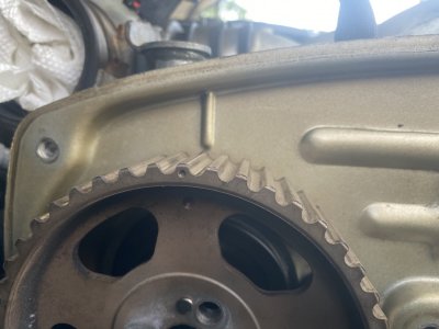

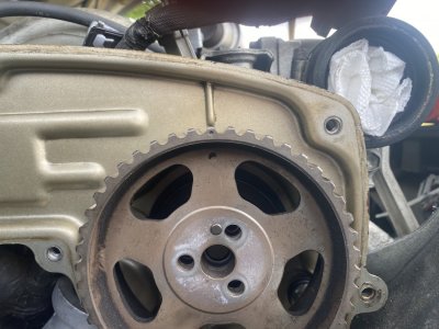

Is my angle wrong or is the 1st cam off by a tooth? Not sure
Well now you can give tips and tricks to the next person!
Its just the angle. The dot is lined up with the line. Also once tension is on the belt it lines up fine. I believe that side is the one where the valves are in the middle of the compression correct?
