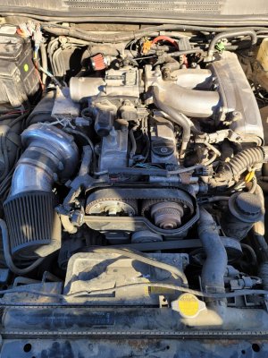

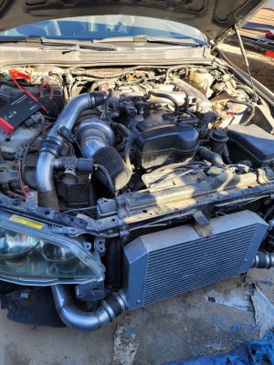

The Lexus is a 2002 IS 300 with a 2JZGE VVT-i. It is has a GTE rotating assembly, with a Precision 67 mm turbo. It is a 5 speed car with a R154 swap. The more I dig into it, the more I will update. It was built by Swift in Maryland. From what I remember, it ran about 5 years ago. Then it was parked. A couple of years ago the owner went to start it, and it was down two cylinders. He did some work to it, but didn't get to the bottom of it, and really has zero interest in it anymore. It has the stock ECU with a Haltech E11V2 stand alone. I don't know if the Haltech took a dump, or something else. I need to get a laptop with a 9 pin connector to communicate with the Haltech (because old) to see anything. Back in the day the Haltech was pretty much the go to for the turbo swapped Lexus cars.
I will start digging into it. Going to check the wire harness, check compression, and try to get it running. After that, I will probably spend a small fortune to bring it into the modern day stand alone wise. I have been looking at Pro Efi (they also have a complete plug and play harness for the IS 300) to update the stand alone. It has a couple of features that I want. It completely controls the VVT-i, boost control, rolling anti lag, 2 step, ect. End Goal? To have a 500 hp Four Door Supra. LOL.

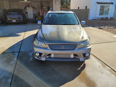

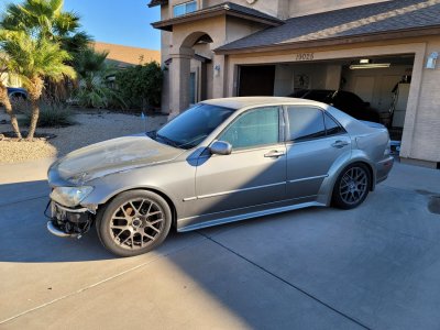

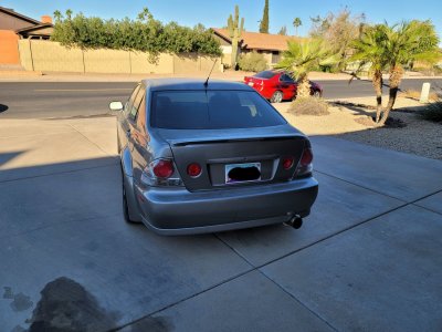

Lexus update: I got it home. First things first...I washed it. Now it looks like a "clean" paint failing car. Lol. Pics are before the wash....Car really doesn't look any different. 20211113 09154120211113 09155220211113 091604
20211113 091525

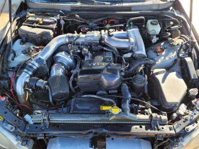

Then I gave the engine compartment a good scrubbing. I need to do it again, but it looks alot better.
Before:
20211105 091433
After:
20211113 094551
Just used my garden hose sprayer, Purple Power diluted 4 to 1, a wheel brush, and some towels.

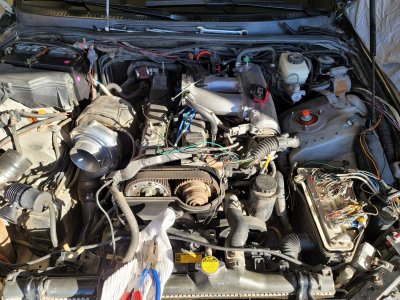

Update on the Lexus. I got it a started and running. Sure enough there is a miss. Actually there is two misses. Both cylinder 3 & 4 are missing. However, they are fired by the same coil. If you know anything about waste spark, then you might understand what it happening. I know the car has 140k miles, and I am pretty sure the coils are the originals. So I bought new coils, new plugs, an new wires. I installed them and yep...still missing.
20211128 104526
The wiring in the Lexus isn't the best. I pulled and de-loomed the coil wires. Looking to see if anything is broken or out of place. Didn't find anything. However, there is a Haltech Triple Channel Ignitor (JDM thing) that may have failed. So I bought a replacement and when it arrives, I will install and see what happens.
