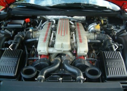

Here's the picture of the Ferrari engine with the similar intake manifold design. This is their design, but all the same pieces are there.Screenshot 20210825 103305
Some more information on variable length intake tracks.

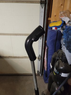

I have been having issues with my noisemaker delete pipe de-coupling under boost. So I took it off, scuffed it up, and then Herculined it. Cleaned the throttle body and coupler, intercooler coupler and did a maintenance check. Sprayed the **** out of the couplers with hairspray and re-installed the pipe. Between the rough texture and hairspray that **** better not come off again.20210919 140152
76FoMoCo
Nov 22, 2018
1,800
1,939
Nampa, ID
I never thought about the texture being a problem well.... until now. Might could sand off the texture just to the point the coupling covers it.
