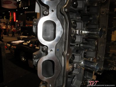

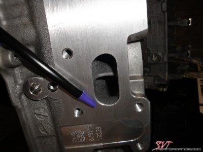

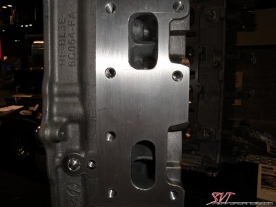

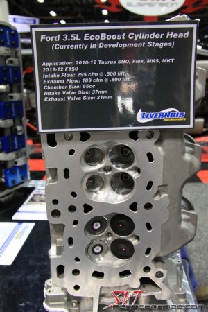

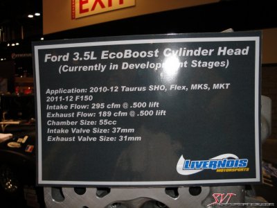

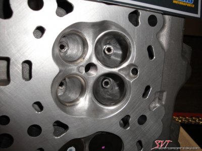

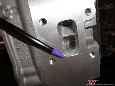

The flow gains are almost unbelievable, but as most people know, numbers aren't everything. We need to get the port finished, then digitize and CNC it and try it on a car to make sure drivability doesn't suffer.

From your previous post, the Intake Flow increased 110 CFM That's a 60% increase.
The Exhaust flow increased 37 CFM or around 25%.
I'm impressed!!!!
Get those puppies on a car!
I'm impressed!!!!
That is incredible. Cant wait to see what this does on the car!
I'm impressed!!!!
Yeah, that's why I said the gains seemed unbelievable....
Now to get them on a car.... :woo-hoo:

boost levels will drop like a brick with increased flow #s like that. i would say installing those heads would mandate a turbo upgrade......

I was amazed at how much better they flow. On my G8, the stock heads flow great, so when I had them ported, I gained around 10% or less. Likely wasn't worth it, but it gives me bragging rights!!!!!
I figured it had to come out the bottom. Would very hard to take off rear headers, maybe impossible from the top.
So... if the head gasket blows due to boost.:dribble:.. it means on needs to get the heads CNC'd at the same time!:angelnot::angelnot:

Interesting flow gains. Now we need to see some stockish profile cams with .500" lift to take advantage of all of that newfound airflow.
You may be right but there is still something to be said about making more power on less boost. At least until there is a big turbo available for the 3.5 EB
