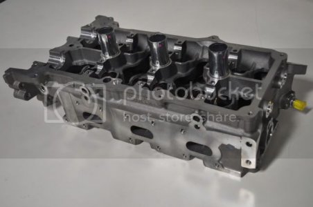

A bit more details if possible Rick for the regular drivers that love speeding, spending, but don't know much by just seeing a picture?
Thanks!
In other words, is this the missing thing to see the 11's?

I take it the stock heads have some major room for porting?
This must be for all the owners who REALLY don't care for the warranty huh? lol! :nut:
Keep us posted flow numbers!! :swing:
Thanks!

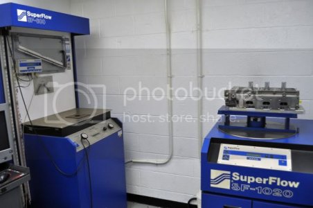

There definitely looks like a ton of room to improve, as they appear to be pretty restrictive as-cast. We haven't flowed them yet, I just set one on the bench to take a photo.
Typically, when we port head for a vehicle with a power adder they gain power and lose some boost. For example, a Shelby with our CNC head typically loses 1-2 lbs. of boost and picks up 15-20 RWHP since it is more efficient. You can leave it as is or bring the boost back to the same boost level before to pick up even more power.
I just posted this is as a "teaser" but will post info as I have more data.
