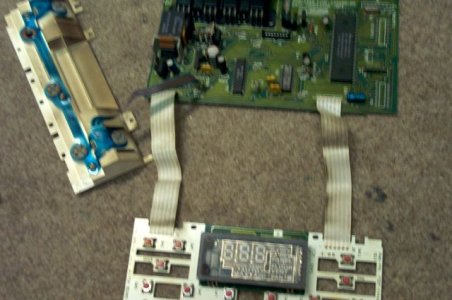

Well, here is the procedure. It is really quite simple. This information is presented with the expectation that you possess average/above-average soldering skills.
Disassemble the old and new EATC units. This is four screws and two connectors each. Remove all of the electronics from each unit. The display PCB on the new unit will probably be held in place by 5 small Torx screws. Remove these screws.
De-solder the two eight-pin ribbon cables from each display PCB. De-solder or cut the two-pin ribbon connector for the light box on the old unit, as it is no longer necessary. The display PCB on the newer units is a multi-layer design, so be careful.
The ribbon cables on the new units are several millimeters larger than the ribbon cables on the old unit, so you have to modify these. You can overcome this in a number of ways, but I will explain what I did. Make a slit in the insulation between all of the wires about a quarter of an inch long. I did this on the smaller cables that are still connected to the main PCB of the original EATC. This will allow you to spread the wires enough to connect to the new display PCB.
Just so it’s clear, you will be using the main electronics of your old unit and the display and buttons of the new unit.
After the wires are re-soldered, install all of the electronics into the new unit housing and put it back together.
After dealing with many different EACT units, I found that Ford used many different designs on the electronics. I have four different styles. The only thing that remained constant was the wiring of the display boards, which is why I chose to modify units in this way. If you have the newer hard-button unit, the face from a late model Crown Vic (as pictured in my first post) should just snap into place without any need for modification.
Good luck to all.

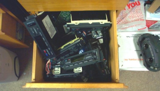

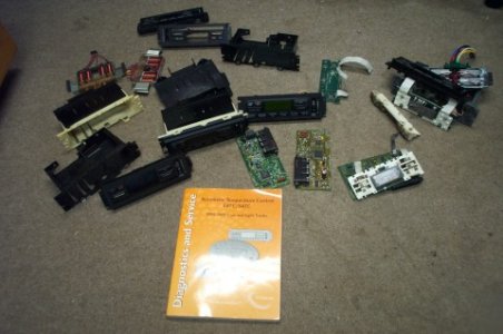

yep all my pre 93 units have 14. here is a picture.
Eatca2 Eatca1
and just to show i'm not bs'ing you or anoyone else some of my eatc units. i have way too many. :p
EATCdrawer
Eatca3
