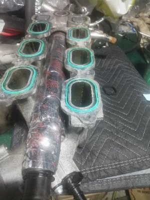

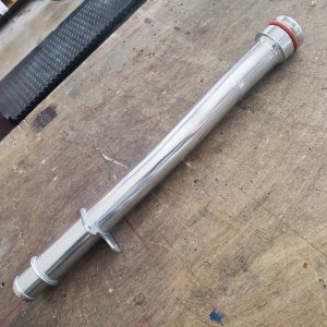

Yeah, I was thinking about doing that as well. I've had mine sent off to Jet Hot to ceramic coat mine.104c270a747862fb7718a86278303e01
Polished your pipe? ()
But really, your on to something by coating it. I can wait to pull some numbers off of the results of insulating mine. I'm surprise I've never seen these mods before now. It seems like such a no brainier especially with all the crying we do about "heat soak" on this platform.

Yeah it was only like $75 to have done. I think I'll put that pipe insulation like you have on it as well. Easy enough to do.

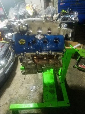

Right?!?! I just finished my engine build and I'm installing it now. But looks like I'll end up pulling the intake when the spacers get shipped.

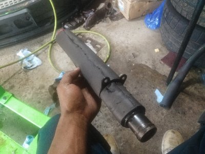

The spacer is what I've been waiting on to complete my anti heat soak protocol for the intake manifold. Got on the list as soon as I saw this on FB! Been waiting months since I saw a cad drawing of it.
Some 1/2 wall heater/HVAC pipe insulation for 1" pipe, wrapped in foil tape.
This coolant outlet pipe sees highest coolant temperatures in our engine. Our aluminum intake manifold surrounds this pipe within an inch on all sides.
The manifold spacer should reduce heat transfer from the cylinder head. I can't wait to get out all of my tc's and temperature capture equipment to see what the difference is with both of these mods in place.
200°f+ temps radiating off this pipe directly on to our aluminum heatsink of a manifold. At idle, on a warm day, 170°f IAT2 temps aren't uncommon after idling for 5mins or so.
High IAT2 temps definitely effect off the line performance. Edbfd2cea2082795c2fb0305f95b0306017408a2d55e90f0886c947e761d8e1cA65da91a9a4e75174513c369489c8f45

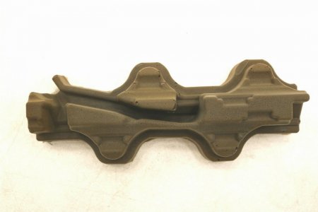

BTW, you're not running into fitment issues with the stock insulator that pipe snugs up to are you? Or did you just remove it and not run it? I guess what you're doing is an improvement over what ford did, I am just wondering if that form-fitted foam is supposed to keep pressure against things and keep them from vibrating as well as insulating. Fuel injectors are right there and I haven't seen how much the OEM insulator is designed to effect those since I haven't removed my manifold yet.

I may test fit it, but I don't think I'm going to need it with the pipe being wrapped insulated entirely.
I'm sure it's also designed to be a sound dampener for the di injectors, in addition to a heat isolator.
