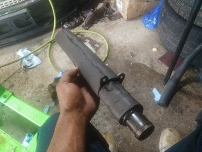

Idk, I understand how conductive aluminum is in regards to heat, but the heat the IM is soaking isn't just directly from the metal block underneath. It's surrounded in hot engine bay radiant and convected heat that a phenolic spscer cannot isolate it from. Not to mention, the hot engine coolant passes right through it via the thermostat housing and underneath it in a metal tube (I've had that tube ceramic coated for this very reason) soaking up that heat.

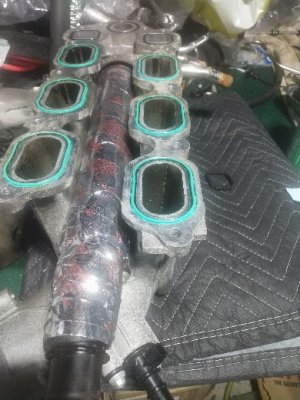

The spacer is what I've been waiting on to complete my anti heat soak protocol for the intake manifold. Got on the list as soon as I saw this on FB! Been waiting months since I saw a cad drawing of it.
Some 1/2 wall heater/HVAC pipe insulation for 1" pipe, wrapped in foil tape.
This coolant outlet pipe sees highest coolant temperatures in our engine. Our aluminum intake manifold surrounds this pipe within an inch on all sides.
The manifold spacer should reduce heat transfer from the cylinder head. I can't wait to get out all of my tc's and temperature capture equipment to see what the difference is with both of these mods in place.
200°f+ temps radiating off this pipe directly on to our aluminum heatsink of a manifold. At idle, on a warm day, 170°f IAT2 temps aren't uncommon after idling for 5mins or so.
High IAT2 temps definitely effect off the line performance. Edbfd2cea2082795c2fb0305f95b0306017408a2d55e90f0886c947e761d8e1cA65da91a9a4e75174513c369489c8f45

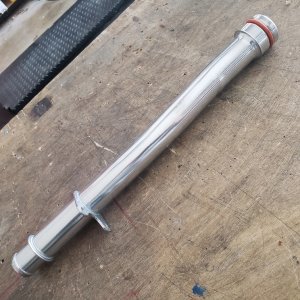

Yeah, I was thinking about doing that as well. I've had mine sent off to Jet Hot to ceramic coat mine.104c270a747862fb7718a86278303e01
