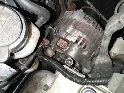

Can some help me understand how the alternator was working so it seemed. I unplugged the connector to test the ohms and all that I forgot to plug it in. I popped the clutch n started it, drove it all about 20 miles the lights did not dim, I was able to use my brights turn everything on as far as the AC the windows the doors locked everything I could to have all loaded one time to see if I could get a red battery and I did not here's a picture of what it looks like I swear on everything I love...
Lol
