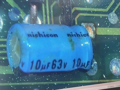

When removing the PCM and disassembling it, one capacitor was bad, it rotted and the leg fell off, the technician said that it was a small thing, soldered another “it had a different power” and answered that it didn’t matter. I didn’t attach any importance to it. Maybe it’s important?
