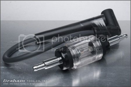

Or we have a spark tester. Cool little gadget, you plug it into the wire and on the plug and it will light up, well sorta flash every time the plug sparks.

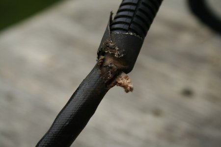

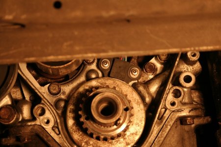

I exhausted all other possibilities. So then I took apart the front end and found this:
Sho help cks all small

Sho help cks close small
(click for a larger image)

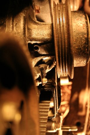

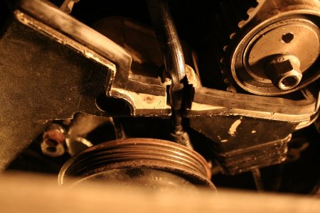

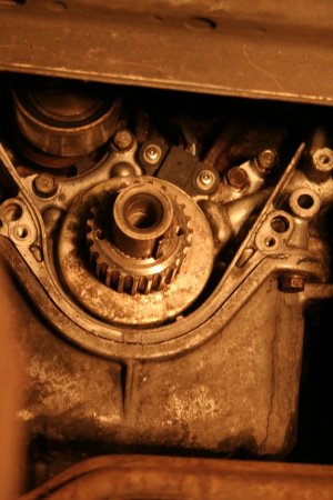

Since the water pump pulley chewed through the old CKS wire, I want to make sure that doesn't happen again. This is how it is routed now, let me know if I am making a mistake again:
(click for larger images)
Sho help cksinstall1 small
Sho help cksinstall small
Sho help cksrouting small

I can't measure that gap, but it looks to be about 1/4in. I just shoved the harness into the gap in the middle timing belt cover as securely as possible, but there really is nothing to keep it in. Does the lower timing cover secure it at all?
7,521
that should work - the wire is pretty tight in that notch in the middle cover, and the lower cover goes over the top of it and keeps it in there.
did you gap the crank sensor properly? It wants to clamp to the shutter wheel on the back side (too large of gap on the side you measure) and if it does that it will tear itself up in short order...

I gapped it by inserting a .030in feeler gauge in between the rim of the pulley and the inside of the sensor, held down each side and tightened down both screws.

I know this thread is really dead, but I figured an update on the root cause was in order. The reason why the CKS was chewed up was due to a missing bolt in the lower timing cover. When I rebuilt the engine, the lower timing cover was missing a mount point. Somehow it was broken off and I didn't even notice it. However during the investigation I noticed that the lower timing cover had play and allowed the CKS harness to migrate from the indentation in the middle cover towards the water pump pulley, which then caused intermittent and disastrous engine operation.
The moral of the story is, make sure the CKS harness is routed properly and is held in securely.
