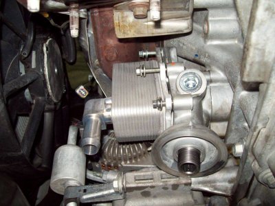

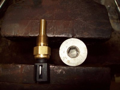

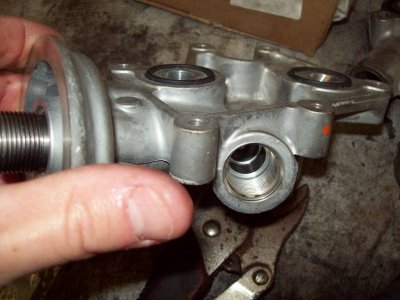

If you have a PP equipped SHO, you can tap into the aux oil cooler, as there's an unused bolt on the housing, that can be removed from the housing, drilled/tapped and the sensor then installed into that opening.
Least for oil temp that is.
****edited to add pics8ad77d8392b158ce811ef1e70c313acdFd4029734fbf195f96da68d88d3561ceC136e6d845d77c6e253282ca1e7cf7b1Fd7d3cf9a8a57b01387d35e9f94602b6

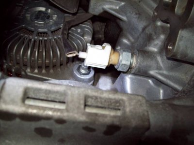

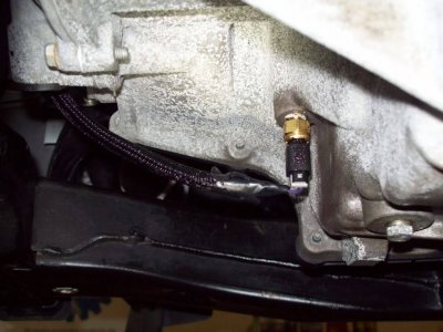

Sensor for trans temp, can be placed into the smaller of the two bolts at the bottom of the trans pan.
It's the one used by tech's to check pressures.
LMK look for pics and I'll edit/add them to each of my replies. Gimme a few.
****edited to add pic27127aa2fd5f066a2f0d1cf73eb91276

I don't have a PP, but damn that's helpful on the trans temp! Definitely going that route then.

I don't have a PP either, however the aux oil cooler can be ordered and VERY EASILY retrofitted.
Seriously it's so stupidly easy.
15 to 30min tops to do it.

Like $100 for the aux cooler itself but you'll also need #11 in this diagram as well.
It's a matter of two or three bolts from what I recall.
Remove the old, original piece, then install the bypass part (#11 in diagram) then place the aux cooler onto that bypass part, re-install the 2 or 3 bolts, wallah. Done.
